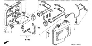

Hey all, I did the unthinkable and hooked up my battery backwards.
It blew the 30a fuse on port side of engine. Did not blow the 15 A fuse above. I tried to start (after I realized it was incorrect, got battery correct and replaced fuse) and got a relay click sound then all is dead. Can't use the trim to lift engine either. I just get a bit if a scratchy sound out of the small Control Relay box in the back port side of engine. Somethings blown, but I just need some troubleshooting tips on exact places to hit up. |
I have my 12.69v on the main heavy lead coming in and I have it across the 30A fuse.
Any help would be appreciated. Damn i'm a dummy
Northerndude
Jul 17, 2025
3
Funny, I checked the V and I ohmed out all connections. I just had a high resistance open in my + barrel at battery
I had a bad connection inside the barrel on my + connection coming from motor to battery. Just need to replace and solder new connection on wires from motor.
