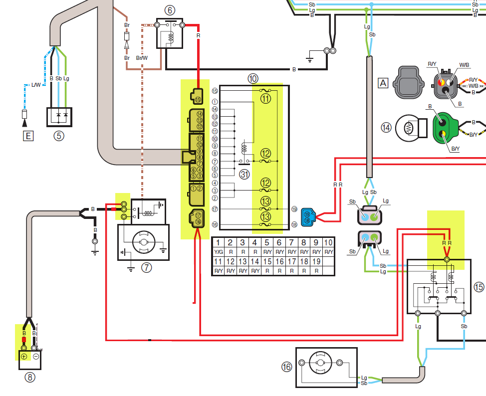

this one does! 2008 model
only power i have to the motor is the power wire to starter and ground and cleaned both connections and have 12 volts there

Get your meter out. Start chasing connections and attach points. Just because a fuse or its holder looks good, don't bet on it.

fixed! frayed hot wire to the starter, couldnt see it until i removed starter
