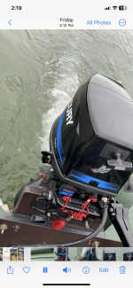

Hey Matt, I have a Amazon knock-off tiny tach on it and my max rpm is 5,700 so I’m in spec. Not sure if these 2-strokes have a rev limiter on them either. But if they do, I should be fine. Nothing I can do to lower rpm either being a jet pump.
