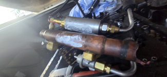

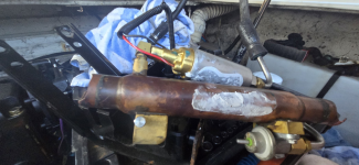

Got it out.. didn't realize I needed to switch this out as an x number of years replacement .. it's about 10 years old.. 1790535303348.png

Anyone know if the thermal paste (white stuff) on the side of the pipe and pump is anything specific? Or will generic paste work sold at regular hardware stores?
alldodge
Mar 8, 2009
44,673
Not seeing anything in the manual about thermal paste. It wont hurt but not sure it has any effect to help.
