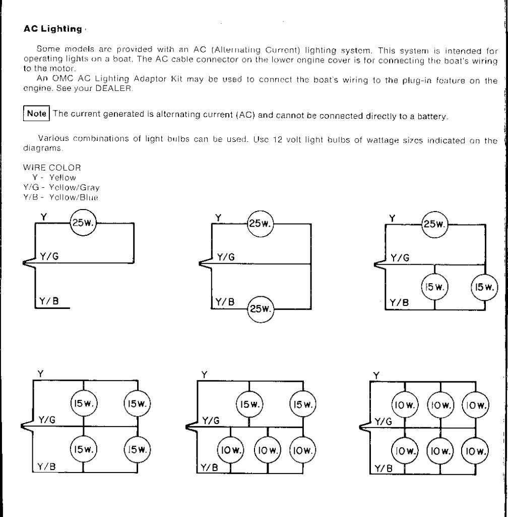

1985 25hp johnson with external a/c outlet. Does anyone know what the output should be from this socket. Im hoping its enough to run lights. Wiring is, 1 yellow, 1 yellow/blue, 1 yellow/grey. Any help much appreciated.:confused:

I think I can help you there:
Image taken from the owners manual for 6 & 8 Hp models. You stator coil may have a larger output if so you will be able to power more lights but the idea is the same.
Electric start models are fitted with a rectifier to enable battery charging. One could be added if you are interested
