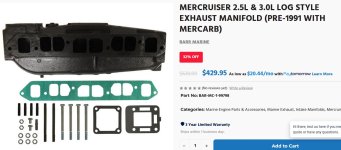

Charlie, Yours must be after '91..? (square ports and 5 bolts).. I'm working on a '87 and an '85 and the one I found has.. sure enough 4 bolts and 2 studs. Pre '91. Still hoping to figure out why studs and where.. and why did they eliminate the one hole / bolt? Anyway.. thanks.. JG
On mine, the studs were on the ends and made it easier to mount to the motor. Mine was 2004.
