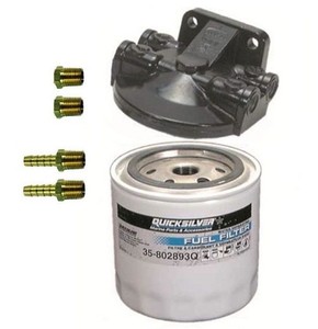

Once he has the plastic filter out, get a proper water separating fuel filter kit put on. Merc do a good one.
