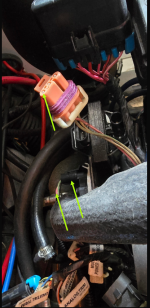

Looked at the shift interrupt switches purple wires, tested them by applying forward and reverse throttle then trying to start, wouldn't even crank so I'm guessing this is correct?

Sounds kind of correct though you'll want to also do a visual as well to the switch mounted on the shift plate of the engine to make sure it's center in the V 'and ohms test the switch to make sure it's working properly when physically moved say by hand and watching the meter...It will be item number 18 but with the purple wires mentioned, you found it... https://www.mercruiserparts.com/bam/subassembly/31500/8550/280
The reason the engine didn't crank over when selecting forward neutral reverse is there is another switch in the shifter handle controller that keeps the engine from cranking in gear for safety reasons of not spinning the prop while someone is still near it say swimming, etc..
