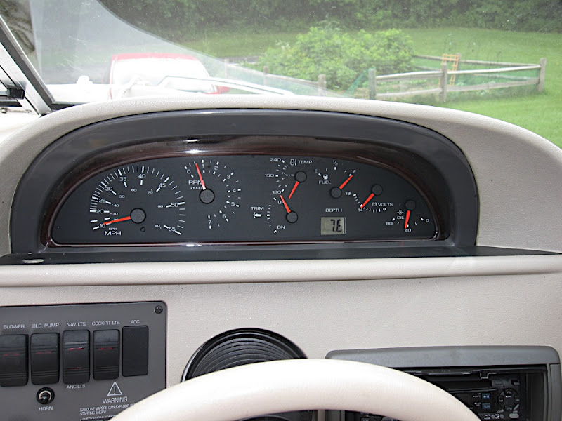

I just had a 4.3L vortec re-man engine installed in my 1996 Four Winns 170 Horizon. The guy who did the work suspected my temp gage as being bad, he said he put two theromstats in and a know working intake temp sensor.
I've put 2.5 hours on this engine, 1st hour at 2000 rpm or below, 2nd hour at 3000 rpm or below.
All on real lake in Brighton Michigan area.
Today, being the 4th, I decided to use my radio shack infra red temp sensor to see if the engine was getting up to "temp".
Set-up:
Driveway with hose for cooling thru I/O drive:
After I had the engine running 10 minutes took these readings:
83.5def f @ Intake manifold:
94.0 deg f @ rocker cover top:
89.5 deg f @ outside of exhaust manifold:
131deg f was hotest I could find, that was base of spark plug:
I'm inclined to think the theromstat is stuck open, and I should NOT run this anymore till fixed, cause there may be some engine damage going on, correct?
If the temp sensor was bad and thermostat working correctly, then the intake should be around 140deg f, correct?
Can I go to Murrays Auto tomorrow and buy a thermostat there?? Plus housing gasket.
(is there any diff between marine one and car one??)
thx for advice.
Here is cluster gage:
