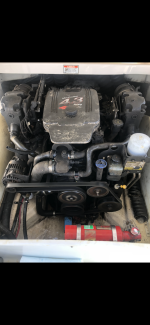

Looking at a 2005 Regal with a 4.3MPI, the broker doesn’t know when the risers were last changed. Looking at the picture (and EPA sticker) are these likely originals from 2005?
Also they look a bit questionable at the rear side?

Definitely looks like they need new gaskets as they have been leaking. Any leaks that you could see? Freshwater or salt

To give you an idea as to cost, I recently put new Barr brand manifolds and elbows on my 4.3 (dry joint style, which appears your are as well). The cost was around $1100 for parts.
