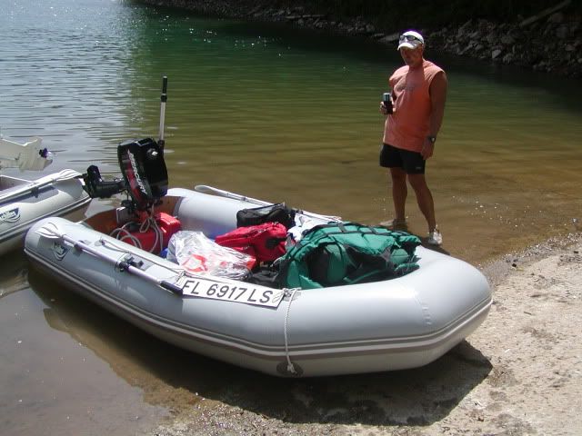

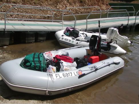

I have a 2002 Achilles with the air floor so it is fairly light. I have been running a 5hp two stroke Mercury on it for years and have changed the impeller once and the plug twice. Since it is a single cylinder it gets amazing mileage even at near WOT. It has a tank in the motor and has an external tank also. I think it weighs something like 50 lbs IIRC. I clocked it at nearly 15 mph with just my 195 lbs. It will run about 9 with a full load of two people, but if you get the weight distributed right it will still do a slow plane.
Compared to my Brother in Laws 9 foot Achilles with and 8hp two cylinder Evinrude, loaded I actually can run faster. Empty he is faster, but not by much. Fuel economy, his is a dog I'll bet he burns twice the fuel for the same speed.
A 4 hp has 20% less hp than a five. I would find the largest thing that:
A) Doesn't exceed the rating of the boat
B) Doesn't exceed my budget
C) Is within the weight limits you can "hump" around. I sometime put mine on the top of my SUV. It is about all I can do to get it (the five) up there by myself.
My 10.5 with 5 hp. It is a great combo. I wouldn't mind single cylinder 6 and some of the 4 strokes are getting much lighter.
We do boat camping in the summer, that's why the heavy loads. Heading 13 miles up the Lake. We probably put another 80 miles on after that exploring when empty.
