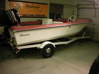

Also, here is a picture of the boat so far.. She's coming along!
