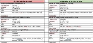

Adding a comparison table that i used when searching for parts.

Your table is wrong with regards to the heads.
