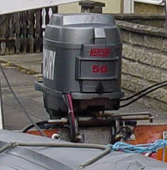

Where's the tiller? central? We dont' get many 50hp tillers over here, but there should be an eye on the front of the engine below the cowl that you'd bolt teleflex steering or the like to. The cable secures through the big hollow bolt the engine tilts on- you can see it fairly clearly in the pic of my older 50hp below.<br /><br />
