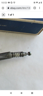

Your motor does not have a 1972 lower unit.-----That set-up was used on the 68 / 69 model 55 HP.----Post pictures of the oil pump.----Yes there is a piece broken off.----And a part may have fallen off and is stuck in pump housing.----Have not worked on one in a while.----I would have to hunt through some parts boxes or take a lower unit apart to refresh my failing memory.
F_R
Jul 7, 2006
28,226
The broken "cap", as it is called presses down on one of the valve levers to close off the oil flow and cause a shift.

Simple fact is.-----It is a 1972 model according to the plate.------BUT-----There are no valve levers on this 68 / 69 lower unit -----Those appeared on the 1970 models !!!!----Any pictures of the power head on this motor ?----
F_R
Jul 7, 2006
28,226
There seems to be some confusion here. The scan that I posted in post #3 is from the 1972 Factory Service Manual. The picture in post #4 shows the spool end of the 1968-69 motors.
68-69 does not have levers and ball valves. 1970-up does have them.

Probably need to get the plastic part out or could cause problems. Here is the link to the eBay picture I sent in post #4 but that was from a 68 or a 69 55 HP that was previously suggested.
