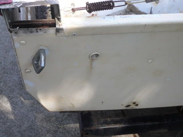

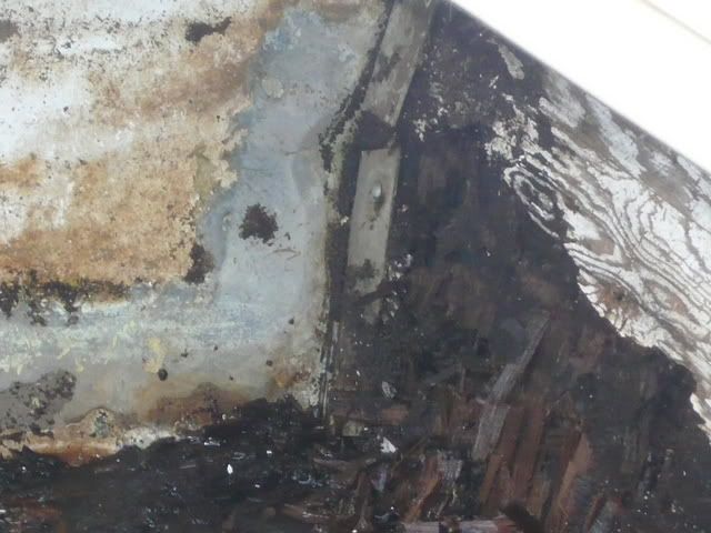

Brackets that are riveted to the hull that screw into the transom.
The cap on the top of the transom has 6 screws in it and a drain hole.

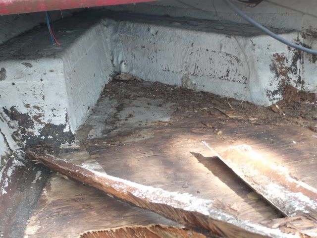

I have yet to get up into the bow but the glass still looks good. Its been out of the elements unlike the rest of the deck aft of the dash.

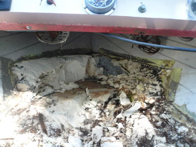

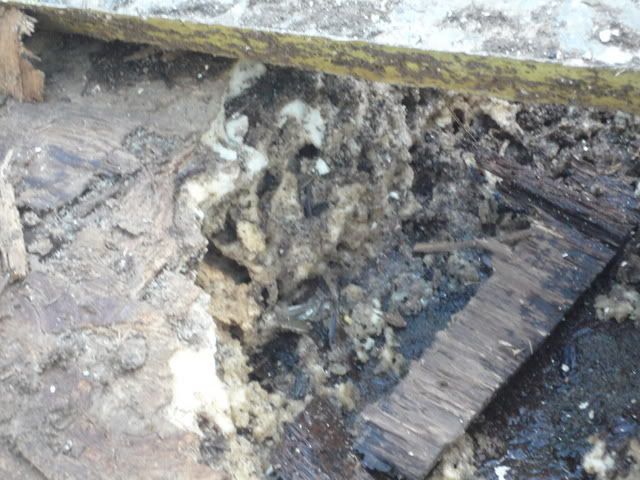

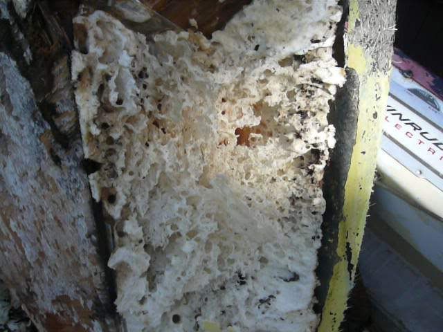

Swiss cheese foam right in the middle of the boat.
I've read a few threads on replacing the transom but I have a question or two. Should I remove the back exterior aluminum transom cover or just try and remove the top cap, pull out the plywood and replace it? If I drill out the rivets and replace the wood in the transom are there any special rivets I need to buy to replace the old ones I drill out or will any kind of aluminum rivet of the appropriate size work? If I try and remove the top cap there will be only 12 rivets to remove if I remove the entire transom there will be a few hundred.
Next question has to do with the foam the ants have tunneled into. Should I cut out the bad parts and when I lay my new plywood deck down just drill holes and pour in the 2 part expanding foam or rip out all the foam and replace it all? Most of it is still very solid, I can stand on it and there is no give at all. I have yet to price the foam and I would like to do this restoration minimizing expense but obviously not quality.

It would e best to just rip everything out, and lay new foam.:) Good luck.

Pull out the floor dust, that's all you have in there, yank the old foam, clean it out and buck all rivets. Then put some Gluvit on the inside hull, to seal it. Then replace the foam, drop in a new deck and start refitting. The demo is the nastiest part of the job. It's best to pull the splashwell...makes access for a new transom easier, and most aren't that hard to pull.

I'd put them ants on the payroll.. There must be 1000 posts on how to remove the foam. Mother nature just made it look easy.
You've got a great project and by taking your time you can easily bring this one back to life.
The first step is to strip it out completely and then assess the hull integrity. You need to check every rivet, tighten them where needed and then, as was previously mentioned, go to town with the GluVit.

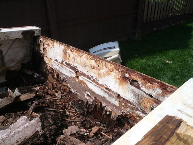

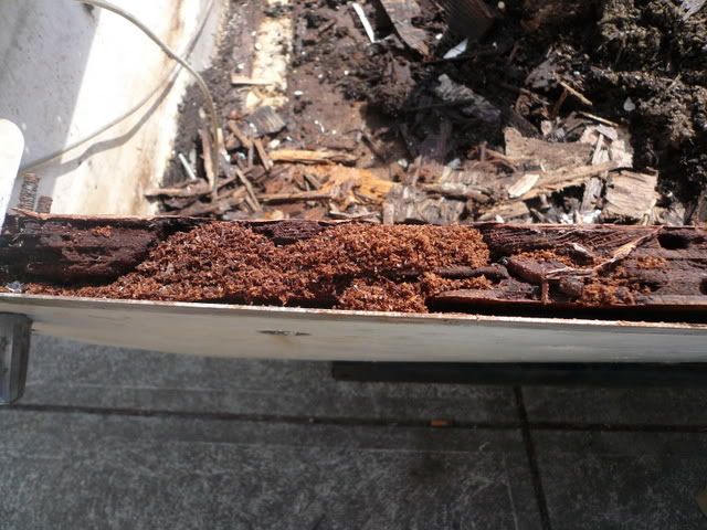

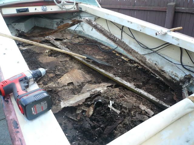

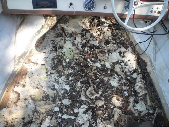

A few updates to my progress. I removed the splashwell then the rotten and chewed up transom board. When I dug into the transom a bunch of ants poured out. Not a whole lot but enough. Then later in the day my nephew say there are ants IN my sun room so when I go inspect I see they are carpenter ants like the ones in my boat so the wife and I run to walmart grab some bug killer for indoor and out and spray the sun room. When I look in the boat again at the bow I see there are ants under the remaining foam and wood so I grab a shovel and pry up some more wood and thats when all hell broke lose I first saw a few dozen but as I pulled more wood up it turned into a few hundred then a few thousand! Infestation to say the least. I quickly grabbed the lawn bug spray and started to wash down the inside of the boat and luckily killed them all. I took pictures of what they did to the foam which in the long run did save me a few more min of chipping away at the foam.

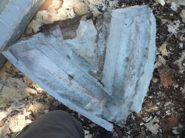

On the right you can see where the foam was, the ants had completely chewed it way. When I pulled up the big piece in the bow almost nothing was still attached to the hull.

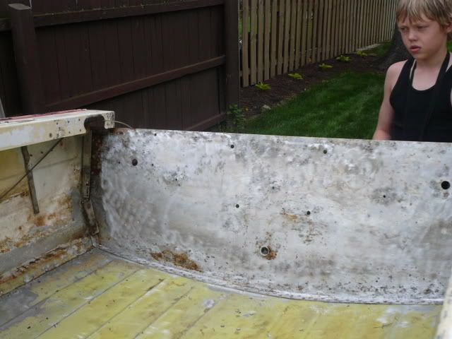

Here is what the transom looked like when I took the splash well off.

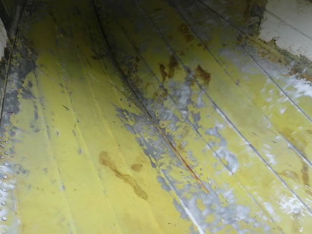

The hull after taking a shovel to the foam to pry it up.
Now I have to get in there and somehow get the rest of the foam up to make the hull nice and clean without banging on the rivets to much. I was thinking of using a 4" plaster knife to break up the bigger pieces then a brass wire wheel on my drill to do a good cleaning.

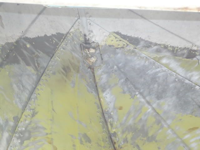

Whew! Foams out! Windshield is off along with the hardware. I had to call it a day after I pinched the hell out of my hand with the pliers when they slipped off a gourmet I was trying to remove. I also found a leak in the keel when I was washing the hull down on the inside. Doesn't seem to be a big problem but there also doesn't seem to be any type of sealer inside the keel seam which probably didn't help the waterlogged foam any. Anyways just a few bits and pieces to clean here and there some sanding then I can get on with the next item on the list.
Looking at the hull close up if the boat had sat there a year or so longer the formic acid from the ants would have eaten a hole right through the aluminum. Its got some pretty bad pitting in a few spots.
