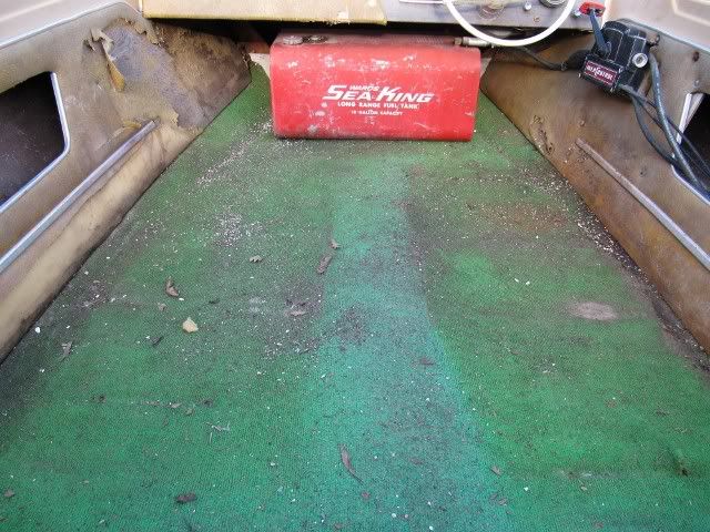

Hah! So I went out to take some pics of my boat, and made a surprising discovery - This is a 1968 Glastron, not a Hydro Swift!
I can't quite read the model & SN, but I'm pretty sure it says "150 G". My initial search didn't pull up anything on that model number, but I'm hoping perhaps someone here can share some knowledge.
As you can see, the deck needs some work
That light part in the middle is raised about 1/4"-1/2" from where the seats were, in the dark area to either side.

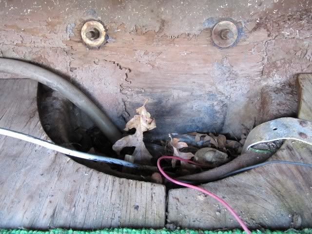

Transom & Bilge Area

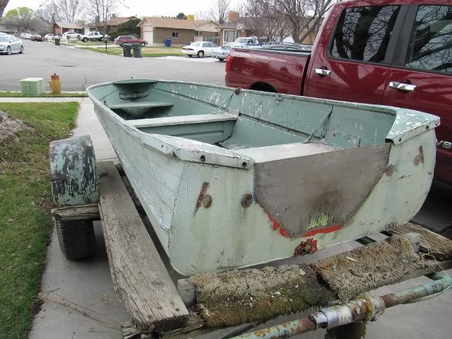

There she is

I am currently debating on whether I should just rip up the deck to evaluate the condition of the stringers, or whether I should use it as-is for the season & make this a winter restoration project. I'm reading the thread Woodonglass suggested for micks110's rebuild project, and man that has got me inspired to just get into it! I can't stop reading it! I don't know if I'll be able to commit that much money as far as the solid seacast stringers & transom, but who knows?
I am a complete newbie to this, so I would greatly appreciate any & all feedback.

i think its a total loss and you should just let me come and get it out of your way!!!!:D,
that is certainly worth a resto whether you can swing the seacast type product or use wood. heck the trailer doesnt even look to bad. nice find.

Nice boat and probably a pretty good deal. It will most likely need a complete refit though. I haven't see too many that have been left to the elements for any length of time with still-solid wood components. However, there are plenty of threads on here for guidance! Good luck with your project.

Definitely a cool looking boat and motor. Really like thos classic lines.
Whether you wait a season or start now, it will most likely need a complete deck/transom/probably stringer refit. But on a smallish boat that is as open as yours is, it probably wouldn't take you but a month or two depending on how handy you are and how much time you have. Heck some of these guys could probably knock that deck and transom out in a weekend (slight exageration, but not much :))

You can't go wrong for what you paid. If you decide not to restore it you could sell the motor and trailer and make triple your money back. If this is your first boat take it out this season and enjoy it because it will be awhile before you get it back in the water. If you start ripping into the boat now without knowing what your missing by having the boat out of commission you may never get it back in the water. (my 2 cents) Just make sure the motor stays on the transom. What ever your time line and budget is you should probably double it. I have a 1968 mark twain 15 foot that I have been working on for a year now. Seacast is expensive and I think unnecessary. Think of it this way, that boat has lasted 40 years with a wood core transom ( O.K maybe it should have been replaced 10 years ago) but you get my point. I am using epoxy resin instead of the polyester resin. Your going to pay through the nose for it but I think its easier to work with and a little less forgiven, what I was looking for, for my first boat. (note I have never used polyester resin so I based this on reading post on this forum). Take allot of pictures, if you decide to ever sell the boat you can prove to the next owner what you did. One other thing---get yourself a wall calendar and pick a date to have the boat in the water by. Each month put on the calendar what you want to accomplish and by what date you want to have it done. It has helped me allot, but I am the kind of person who gets easily distracted.:D

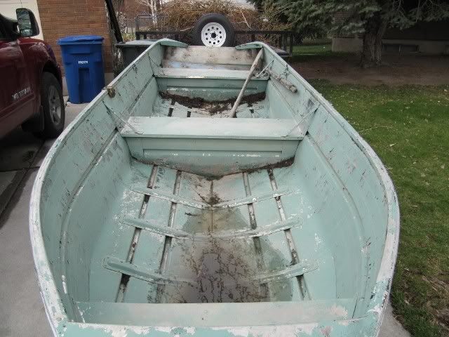

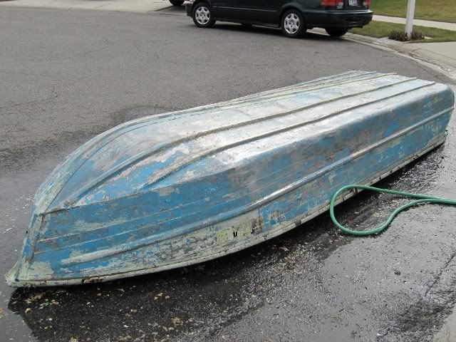

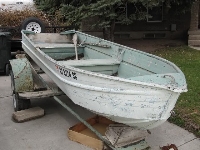

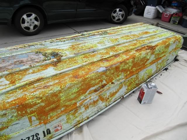

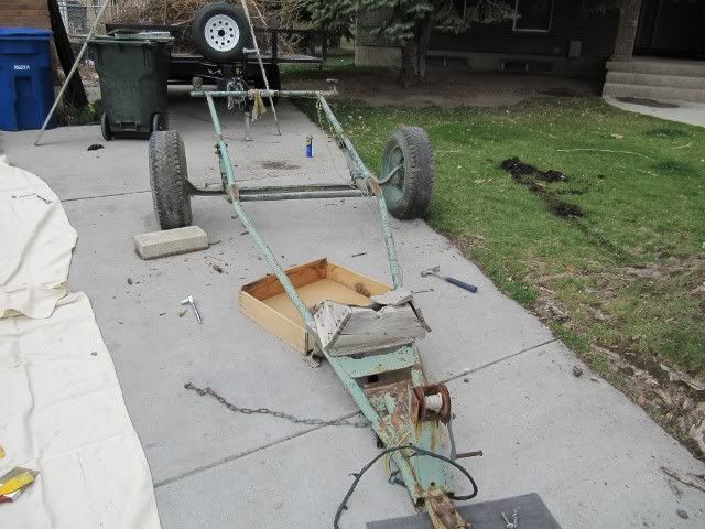

I am actually helping my brother-in-law restore a 14' aluminum john boat too, here are a few pics from last weekend's work....
Before
Paint stripper applied....post 15 minutes or so
Trailer....it's in bad shape, don't know if it's worth it
Finished with outer hull paint stripping, first application at least
Everything's rinsed off & awaiting another coat of stripper, or maybe we'll find a sand blaster in town to get down to the metal
Next weekend will be the inside of the boat.

Yep..Its that 14 foot tinny that made me post..lol
Glass boats..ehhhhh :D
DONT SANDBLAST THE ALUM BOAT!!!!
There are guys that use baking soda, wont eat the alum up like sand..
And you can keep old paint on tin cans as long as its not chipping and flaking..
Sand down a bit to get adhesion, wipe down with acetone, or vinegar and water..and roll paint on with closed cell foam rollers..

Good advice CheapboatKev, thank you! My brother-in-law got this for free from his father-in-law, after it sat in his backyard for 1 1/2 decades. I'm not meaning to post a project on a non-glass boat. I just thought it was an interesting side note since I guess I'm technically going to have 2 active boat projects... Do you need to put any foam in any part of an aluminum boat? I'm thinking perhaps under each bench seat maybe....?

No worries..Its cool that ya have 2 things going on at once..
As far as the foam, I personally wouldn't bother.
If a tinny that small swamps, there isnt enough areas under the seats to really help..All in my opinion.
But since we have that 14 ftr out in the open..lol
What kind is she? There is a TON of us Starcraft tin guys here and lots of other models too, I also just got a 14 ft 1950 sumthing Lonestar
