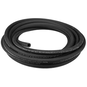

Yep, you can use 1/4" fuel line and slit it with a Razor Knife. Wash it with Acetone to remove the lettering.

I like that! Would you then glue it or something to the aluminum? Or what would you use to secure it?

Some 3M 4200 would work, but I would think that if they are cut "To Fit" they wouldn't need anything but friction to hold em in just like any other rubber grommet.
