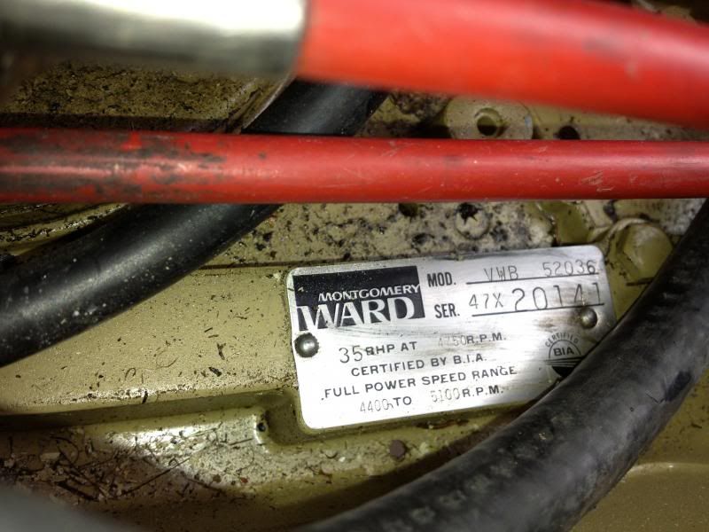

I just got a Sea King 35hp outboard for my 1988 NMZ fiberglass boat, and when it was wired i was unable to get the engine to turn over by using the ignition, I've double checked the wiring and everything looks to be wired correctly, and i've checked the battery (even used a marine deep charge) and still have no power. I'm also unable to get the fish finder to turn on when the ignition is on.
can anyone give me any advice on what i can check to get this to crank up?

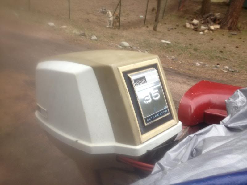

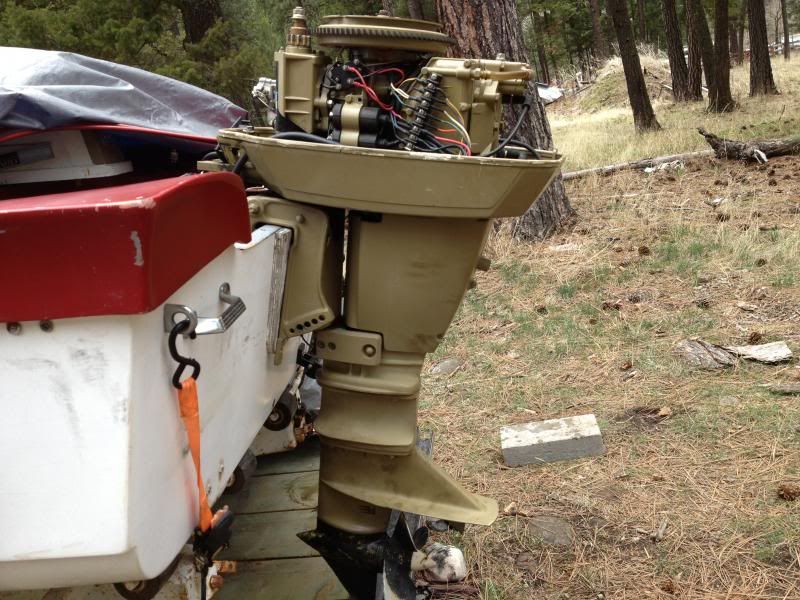

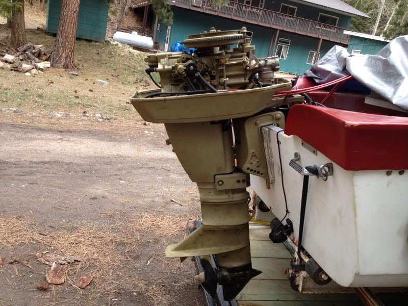

here's the Pictures as promised (now that it stopped snowing)
Right now I have both cables screwed into the holders, but the ends are not attached just in case I have them in the wrong spot. as far as I can tell the top cable is the throttle cable and the bottom is connected to the gear selector.

With the remote control handle in the neutral position, the motor end of the shift cable will be half way extended. The throttle cable will either be all the way extended or not extended, according to whether it is push-to-open or pull-to-open.
EDIT: The knob beside the control handle is to disengage the shift for starting and warmup. With main lever in neutral, pull the knob out. That disengages the shift function and the main lever will only operate the throttle. Return lever to neutral, and push the knob in and the shift will function again.l
