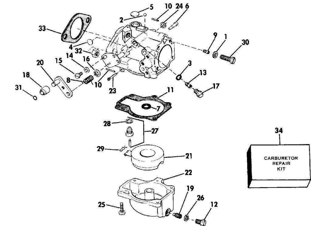

A big thanks to tashasdaddy getting me going in the right direction. But a few questions after disassembling my carbs last night. What is this and where should it go?
Second, the carb kit references a 'retainer' between #9 and #1 and possibly someplace else (don't have the instructions handy)
Is the retainer needed. My carbs came apart just as the diagram indicated.
Any help is greatly appreciated.
Joel

9 is the jet, 1 a washer, the little round ring with the ear goes in the slot then the washer and bolt. this act as a gasket, to keep the jet from sucking air. see red in picture

sorry forgot that. these kits are made to fit several carbs, that is a part for a different carb.
