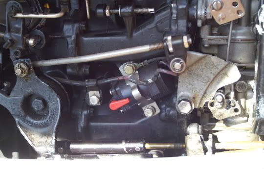

Couple of things I have noticed. <br />Plugs are dark and wet after the motor runs.<br />Primer bulb on fule line never gets tight.<br />Fuel econ is really bad. <br /><br />Motor does not have the vro pump on it, have the bypass pump.<br />New coil<br />New plugs<br />Carbs were taken apart and no trash was found<br /><br />Is there an adjustmet to run the carb lean or rich and where is it?<br /><br />This is the picture of my choke, I'm almost 100% that its set correctly.<br />

Just a couple of things Scott, First, from your picture, that is a primer not a choke. It injects fuel directly behind the carb on startup. Second, in that picture is the throttle at idle? If it is, i would suggest a link and sync as it looks as if the throttle pickup is early and opening the butterflies before the timing is ready.

Jim, <br />I don't understand if its a primer and not a choke how come it clicks when you push the choke on the key choke? Could you come up with the part number and name that Johnson calls it? <br /><br />Also, what are you talking about a link and sync. Guessing I would say your thinking my throttle isn't in sync with the advance of the ignition?
