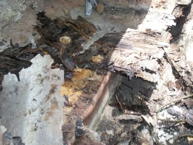

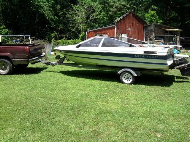

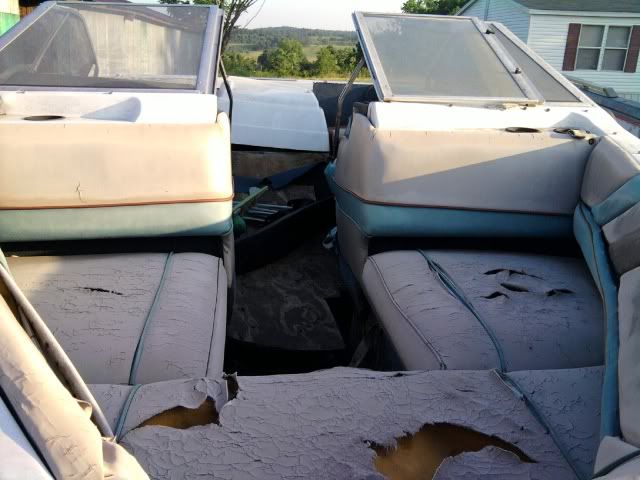

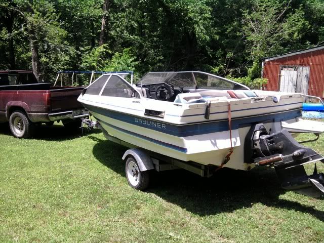

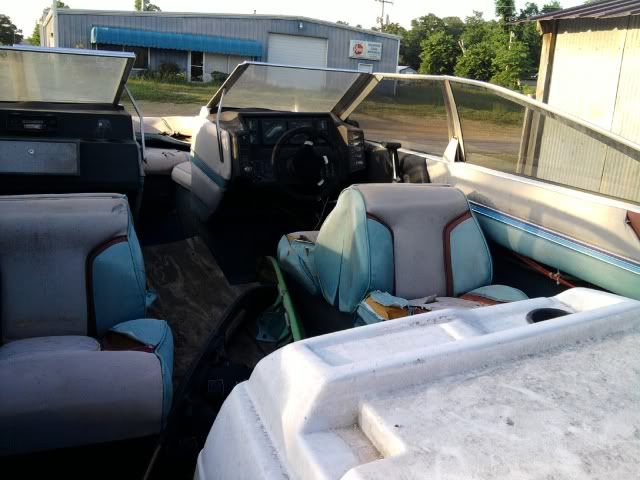

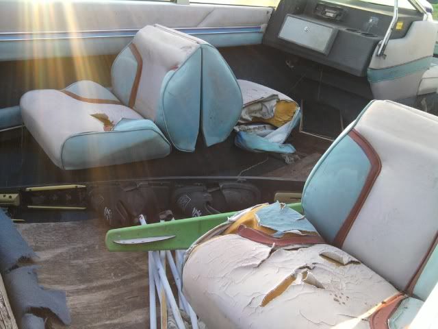

Hi, i'm new to this forum and to the boat scene as well. I've been reading alot on here and I can tell this is a great and very informative forum. What i have is a 87 Bayliner Capri which i'm in dirt cheap. It was not very well maintained for it sat out in the weather for a while judging by the interior. I'm going to be replacing the floor and interior myself. I love project and fairly decent with tools so i'm confident i'll be ok. I was just wondering if i can get some pointer on doing the floor and where to buy my supplies i'll need. I'm going to being replacing all the floor, stringers, and interior, etc...my biggest worry is the floor. If anyone can point me in the right direction i'd greatly appreciate. Thanks for all the help. Here are some pics of the boat.

the reason i laugh is because that is allmost the identical boat that i am working on at this exact second......the exact same things...the deck...the foam...stringers...the carpet...the upholstery......exactallly....
you dont know me here.....but i kinda know my way around boats a little....
ill post back as soon as i can with pics....but feel free to pm me with any questions and ill post the answers...
one thing very important.....when you start cutting the deck....your gas tank is in the center of the boat....just aft of the ski locker.....DO NOT CUT INTO IT.
look in the ski locker...that is where you will see the main stringers....after you have located them....start your cuts 2 inches out side of the stringer....
this may sound like greek to you right now....but ill explain later.
first thing is first.....just take everything out of the boat including the carpet......dont remove the rear seat boxes yet....or the dog house frame...lets just see whats under there first before we start pulling motors....

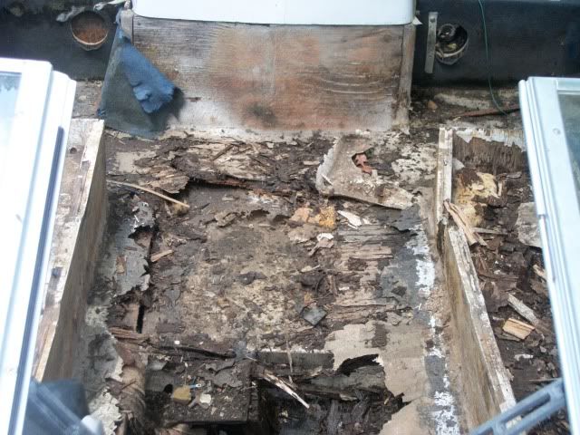

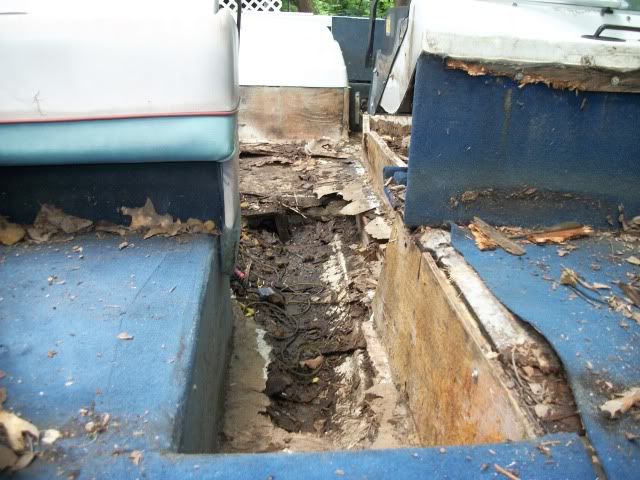

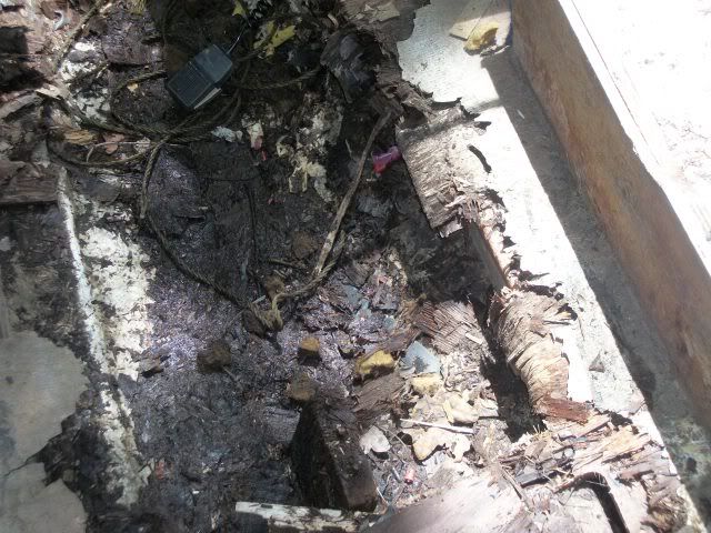

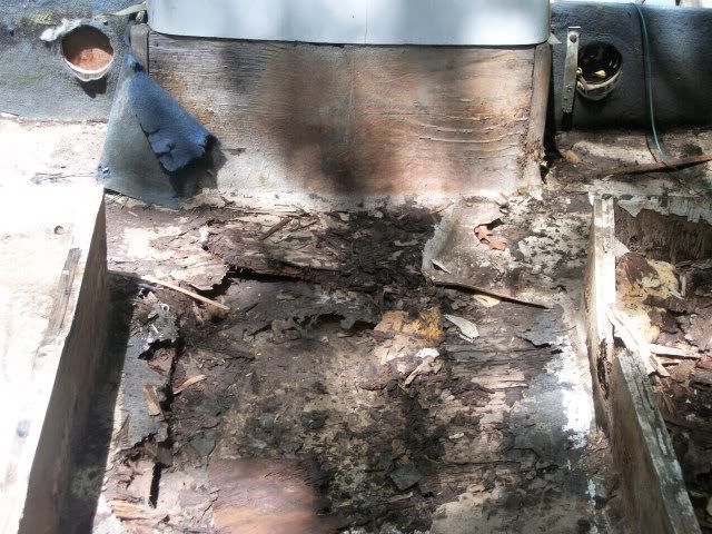

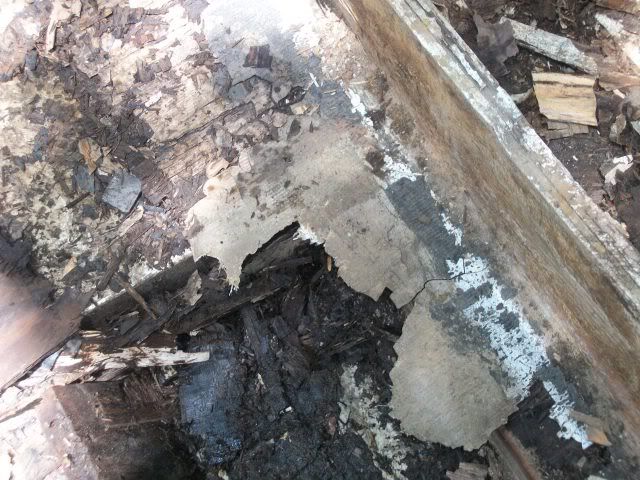

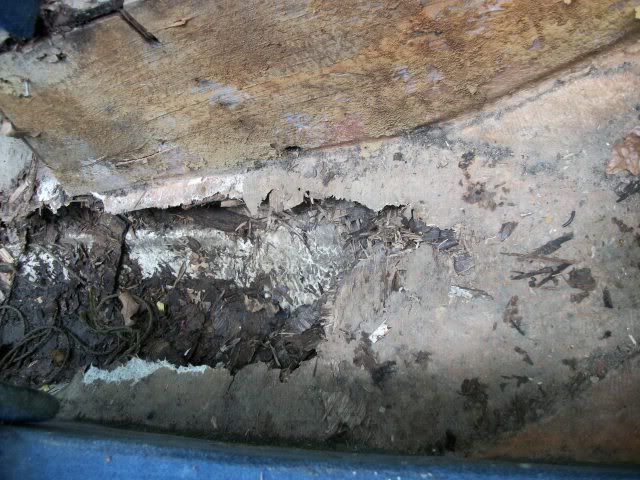

Well i got the seats and carpet pulled out today and pretty much guessed at what the floor was gonna look like. It's pretty rotted all the way through. The only good spots were around the motor. The stringers look like they are in pretty good shape. Any suggestions on if i should replace them or use them? I've heard Bayliner did good protecting the stringers but just wasn't sure on what to do. Here's some pics.

Re: 87 Bayliner Capri Resto
Good luck on your project. I have a 87 Bayliner with a outboard so the setup is a bit different than the I/O's but I am restoring mine now also and just about complete.
Lots of time and money, have fun and welcome to Iboats.
