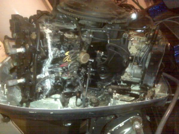

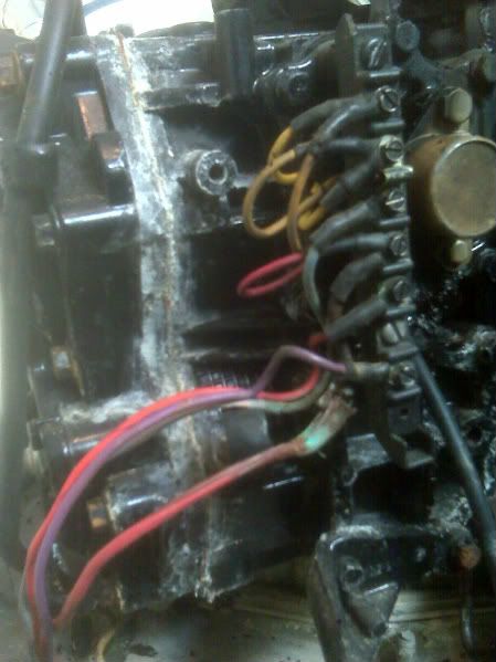

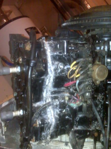

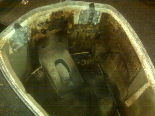

My dad and a buddy of mine both said that--look for the flash point. And I think I may have found it....
Here's the inside of the cover:
The side of the motor where the fire was:
And then look at where the heat seemed to be concentrated:
Based on the above, it appears that these wires are to blame, but they're not burnt... :confused: :confused:

Maybe it was something under those wires, as somebody said that it would be right below the worst damage....
I posted the pics because I don't know a whole lot about what I'm looking at here.

I dont see one in your pics, but is the fuel enrichment solenoid (often called the choke) in that area? On my 1982 Evinbrude 115, it is in the exact area that has the worst of the damage on yours, but my wiring is different, If yours is there, or close by, it may be leaking.

I just talked to the guy who worked on it for me to get it ready for the water, and he said that there's probably resistance in one of those wires, either by bad connection, or corrosion (it was used in saltwater before), and that the wire block got hot enough to catch the foam on fire.

So the question still remains, what caused the ignition to start the fire? Something had to have shorted or thrown a spark if it ignited fuel sitting in the pan.
I do not feel very confident in the mechanics decision that the terminal block got hot enough to catch the foam on fire, when none of the wires in that area appear burned.
I'd like to ask a question as well here, was there a visible flame from this fire or more like smoldering smoke, with no actual flame visible? That could explain the foam melting and some electrical tape getting messed up, but no sign on actual burnt wires. That would lend to the mechanics theory of hot teminal block.

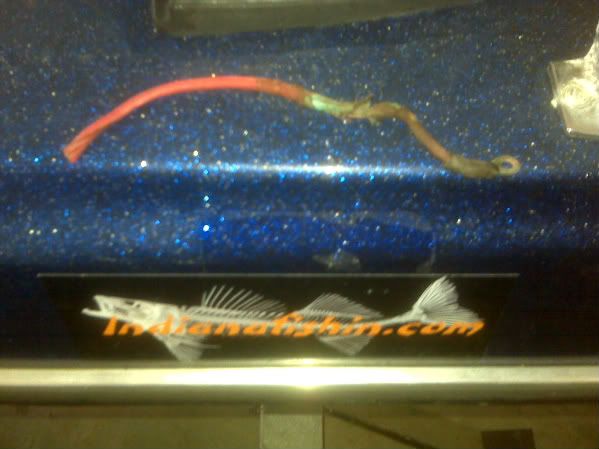

Yeah, I think I may have found the short. The guy that worked on it for me helped me track it down. It was the hotwire off the starter solenoid that goes up into that wiring harness.
When I peeled the tape back on the wires, I saw that the brown wire that was corroded was actually red, not brown----it was burnt.
Yes it was smoldering, more than flaming. Small flames.
