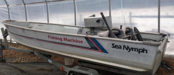

I had total motor failure on the Johnson 25 a while back, and rather put a newly rebuilt motor on my hard luck body, I did a resto on the Sea Nymph and afterwards starting feeling what I believe is a propeller issue. Those pics to follow.

I wonder if someone could verify if this is the correct propeller ( 13-11)for this motor or whether its condition would cause me issues. The boat just doesn't "sound" right as it cuts a wake, kind of a warbley sound and a bit more engine movement than I think it should have. I know one of my motor mounts is starting to give up, so I may be experiencing a confluence of issues.
It's most noticeable at half throttle and below, top speed is not effected, I can top at about 24, and boat planes out fine. Any advice?
