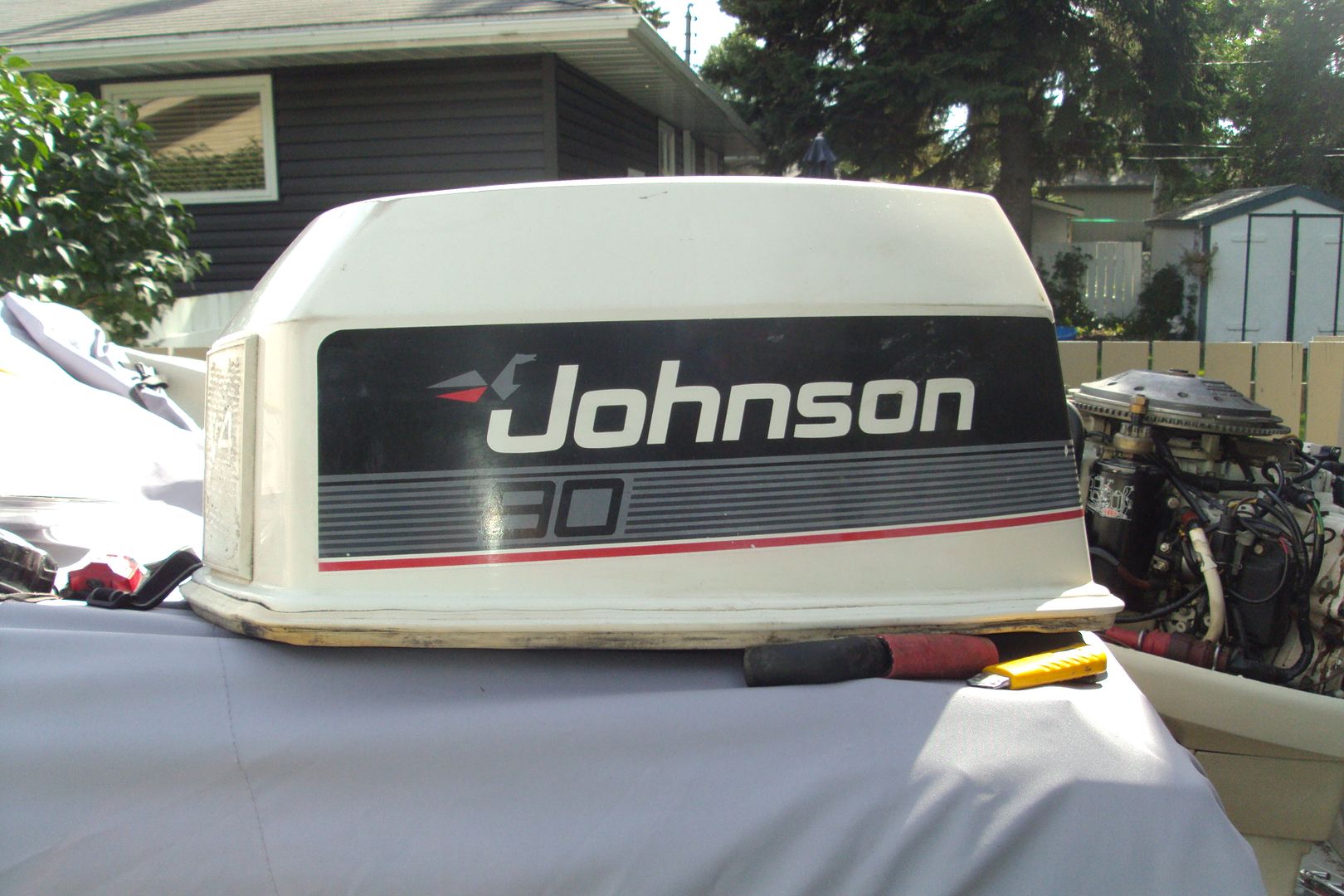

One of my water hoses developed a crack and began to spray water all under the hood furthest away from the carbs at the rear. The engine began to hesitate. Ive done a comp. test and they all check good at 120 psi. Since the water hose cracked, i have had the engine hesitate and try to clear and go like it did but its gotten worse. Last night after dark i took the plugs out (looked fine) and spun the engine. It seems the one side has week spark. The engine ran perfect before the water sprayed under the hood. Any thoughts on what may be happening? thanks in advance

Yes...freshwater.All great advice. Ive pulled the hood and let it sun dry for a couple/few days to no avail. By the looks of how much space is between flywheel and base..theres really not a lot of room for water to get in there...i will try the hair blower trick and get back.thanks so much so far
