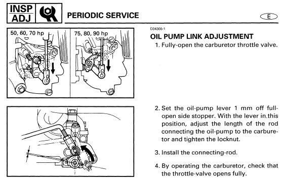

Recently acquired and looking for an oil leak at the bottom of the tank, noticed that the lock nut on the oil pump linkage is loose and backed right out, The threads on the rod are exposed a good 1/2 inch. How much of the thread should be showing to ensure good lubrication. Does anyone know the set up procedure.
