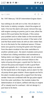

Is it a constant beep or a beep....beep....beep.
I keep reading a few things it could be and a couple of posts said bad stator makes the alarm go off.
Here is my new such post.

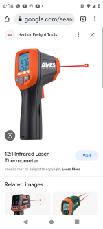

Solid beep means overheat. If your mechanic says "no overheat" and you believe him than your overheat sensors seems to be giving you false signals.
If you want to double check your mechanic, get one of these from harbor freight and check head temp. 140 to 160 range than once warmed up.
No need to have much mechanical knowledge.
If okay learn how to test sensor.

that sensor should not close/alarm till motor is about 200+/- degrees so no doubt if motor is hot or not... that little heat gun from HF is well worth tha investment though..
