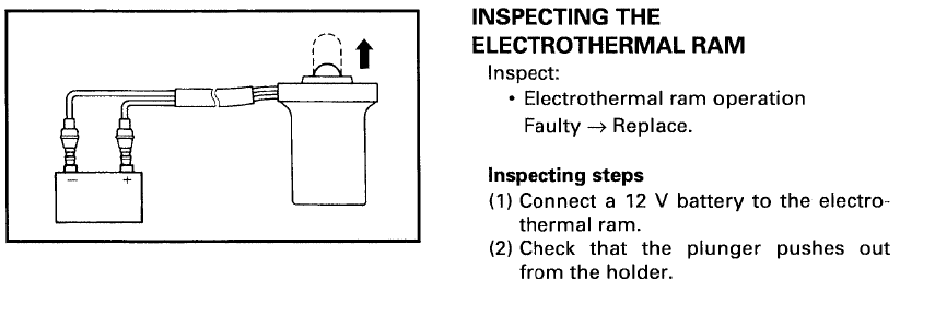

I completed the electrothermal ram test as illustrated. It extended about 1/8-3/16” and is bouncy at full extension. I think I needs to come out about 1/4” and be firm to work properly by my observation. It extended about the same distance as it does when running normally on regulator power
I had 7V at the green and white lead with the other lead grounded directly to the frame while running.
I did the rectifier tests as outlined and the results kinda stumped me. My meter read 530 for all the leads that are supposed to be 0.3-0.8. And 916 for the lead that is supposed to be 0.8-1.3. I’m assuming this is an error in scale?
Stator checked out fine.
I am leaning towards worn out electrothermal ram at this point. Just don’t really wanna spend the $2-300 on a new one.
