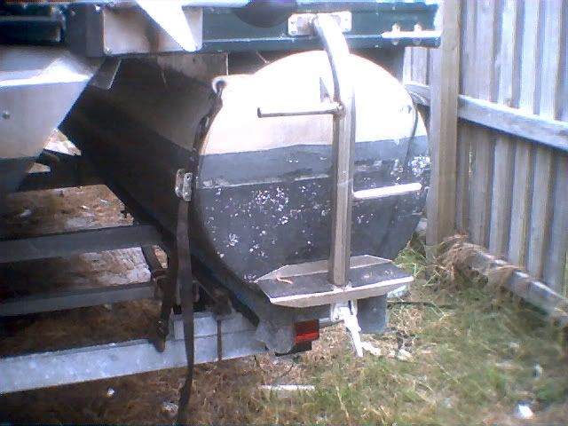

I have been doing a lot of mods to my baby pontoon boat, naturally I work with stainless steel so I seem to build a lot of things from my scrap pile,
I wanted a boarding ladder but wanted it to be simple and effective, this was made from some old p w c handle bars and a couple of pieces of stainless laying around, the center tube was once a swimming pool ladder.

Nice touches. One suggestion though would be to install rubber crutch tips on the boarding ladder steps. Those exposed edges -- whether or not they are smoothed off can cut deeply if one should slip. There are very large veins in ones leg and they are easily cut. Anti-slip pads are also available to wrap the top half of each step to help with footing.

they have black nylon inserts at the end slip on tips over the end can slip off, and the rungs are not at all slippery or I would have done the rubber like I did on the bottom step,, that one was slippery, plus there is rubber strips between the stainless and the aluminum to prevent dissimilar metal contact and corrosion,, plus zinc blocks under the base,, ain't my first rodeo,, lol didn't want to confuse people with the facts.
