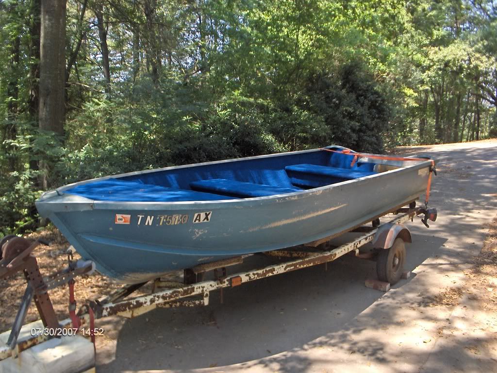

Picked this up yesterday. Though the inside looks nice, it ain't. We are gonna do a pretty good conversion of it. Here is a picture of the start.

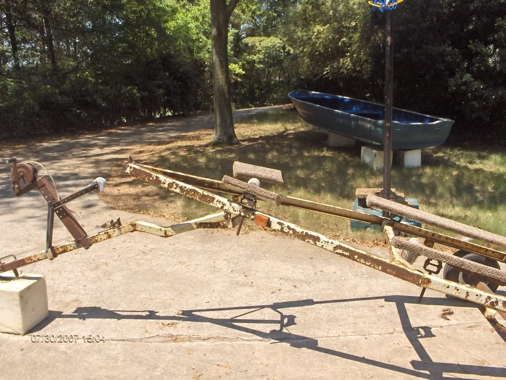

Here is one of the Moody trailer before we started.
As you can see, it is a tilt trailer, and we have no use for that, so we are gonna remove that feature, and weld on a bit longer tongue instead.

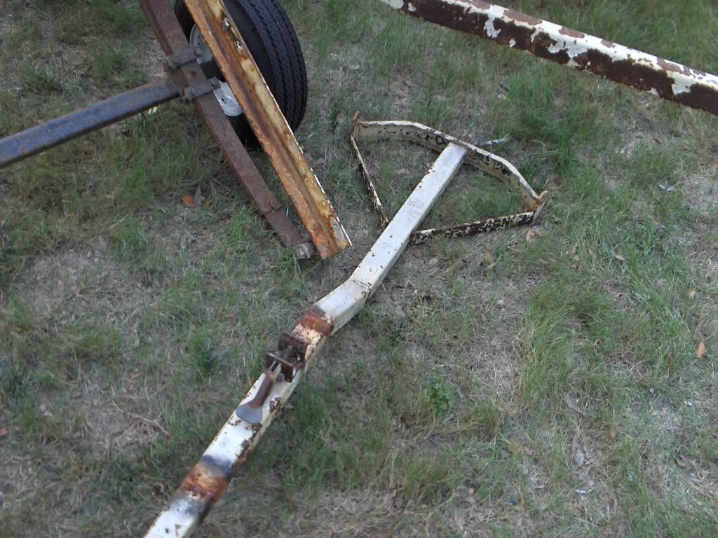

Here are a couple of pictures of the trailer after I spent an hour unbolting everything that isn't welded.
As you can see in the second picture, the spring shackles are welded to a piece of angle iron. This has holes drilled in regular intervals, and the trailer frame has identical holes all the way along the frame. The axle is infinitely adjusted with just 4 bolts. And the bunks have the same pattern, so the adjustment is limitless.
In the third and 4th picture, you can see the tongue and tilt mechanism. We are just gonna weld in the straight tongue and one crosspiece where all this heavy useless crap is.
For getting rid of the heavy rust, we are using some stuff the seller told us about (he is mechanically inclined, and didn't do any of the shoddy work on the boat - he recieved it in payment for a debt a couple hours before we bought it. He told us about this stuff that is made to prep a bit of dry concrete if you want to lay a new pad on top. It has a bonding agent that sticks both together. It supposedly will eat the rust, and turn it into a special coating that will hopefully prevent rust in the future, better than paint would.

I do lots of decorative concrete and none of the polymers that I have used for bonding agents really have any effect on rust. Let me know the product you are going to try and I will do some checking.

Wow !
That trailer looks better than mine did .
I tore mine down and had it the old fasioned way ,
ye olde grinder and wire wheels .
I have never gotten good results with those fancy , expensive , stinky , chemical concoctions .
IME , better to go to good metal and prime / paint .
Two coats of grey enamel primer , followed by two coats of white enamel paint (tractor paint , no less..) .
New lights and wires .
New coupler and chains .
New winch.
New bunks and rollers .
Recentered the axle , was exactly like yours .
New bearings and races .
2 new hubs after 1 cracked(been doing this crap for 20 years , and this is the first I can recall ! ), and , NOBODY had a 4 hole 1" spindle hub .
Ended up buying 2 hubs with pressed in studs .:mad:
3 new tires and wheels , plus , a mount for the spare .
Bearing buddies ,and ,the old good spindle and bolts packed with new races/bearings for a spare .:cool:
New folding jack .
Still need some guide ons , but the 12' is plenty light .
I can reposition it even when out of the water and fully loaded .
BTW , those bracket on your Grumman are probably for an outrigger setup .
You can buy brackets for that canoe that mount an outboard .
It should flat move with that 4hp and 1 person .
Mine sure does!
Are you putting in a front casting deck on that Cherokee ?
Before you think about using wood , check your local recycling center .
You can probably buy scrap aluminum at reasonable prices versus new cost from a metal dealer .
I got 2 4'x4' sheets of 1/8" aluminum for scrap price , plus , various pieces of angle , u-channel , square channel .
Also got some thinner plate scrap (old Hummer doors !).
The stainless steel bolts and screws may get pricy , but you wont have replace it in the next 50 years .
I couldn't find any 1 1/2" plate 2'x4' , or , I would have replaced all the wood in the transom .
Price THAT hunk of aluminum new!:eek:
Also , I've occasionally seen aluminum plate scrap on Craigslist , so keep an eye on that site .

Also, on the casting deck, we are definitely gonna use aluminum for the framing. Going to the scrapyard tomorrow, got a load of scrap to sell already loaded. But, as for the deck, dad talked me into using plywood for the actual deck. Instead of using stainless screws, we are using aluminum marine rivets. The compressed air powered rivet gun is much more practical, and if we need to attach something through the hull, we can do so just fine.
