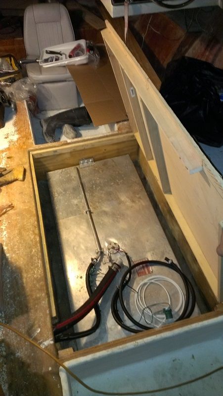

pics:
original floor
I eventually ended up creating my own tank floor section:
Also I built up a raised portion around fuel fill area to keep water out, I'm a bit shocked that the manufacturer just left a hole in the deck open for water to drain right in!

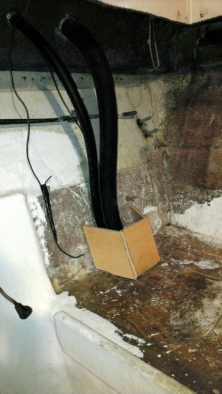

I cut out the access hole to gas tank today. I machined a new cover for it, 13.5". The original access hole was 6", now its 11". I can now get a screwdriver to remove and replace gas line to motor, as it was cracked. The big hose is the fill hose line and the other i'm assuming is a breather line. Those hoses dont look great, but i dont believe they are leaking. I dont see how the heck i would replace those hoses without tearing the hole floor apart if they do leak. I dont smell fuel vapors. I don't no if i have enough space to remove fuel sending unit if i had to replace it. hopefully still works. Have not received starter yet and need to get a new battery. Here's a few pics.

Nice, I like that cover you made, fancy! You may find that once you get those old lines off of the tank fittings, that the hoses will slide under the deck easier than you think. Like I said, I was able to run new lines without needing to rip up my floor. You will need to tape the new lines to the old really well in order to snake them through. I'd pull a new ground wire as well for tank to fuel filler neck grounding while you're at it. If the hole in the floor is too small where the lines come up, you may need to relief cut it a bit larger to make it easier pulling the lines thru. You can always patch over the cut-out floor section when finished with a small piece of plywood and/or fiberglass. Good luck.
