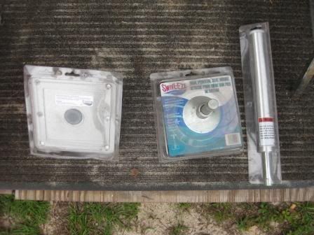

The only thing I can think of are the swivel eeze seat parts... you get a piece that mounts to the bottom of the seat, a base for it to go into, and then there is an "add a pole" part for the middle(couple of heights available) if you want to convert it up to a pedestal seat... the center pole is removable, and stowable. The only drawback is, it does require you to drill about an 1-1/4" hole in the deck for the pole part to go down into... I know you said you didnt want to drill big holes, but only thing I can think of...
here are some pics:
Hope that helps!

I just got mine from wally world aka walmart.
They aren't as "sturdy" as a solid pole would be (I wouldn't drive around with someone sitting up on it when the pole is in), but they work fine on my bowrider for fishing... (basically decked the front, and stuck one in the middle to do like you do, fish, ski, everything).

I am sure there are other things out there, this is just what I use because its not as expensive as most systems, and when the seat is out, it just leaves a plate on the deck which is very low profile.
Hope that helps!
