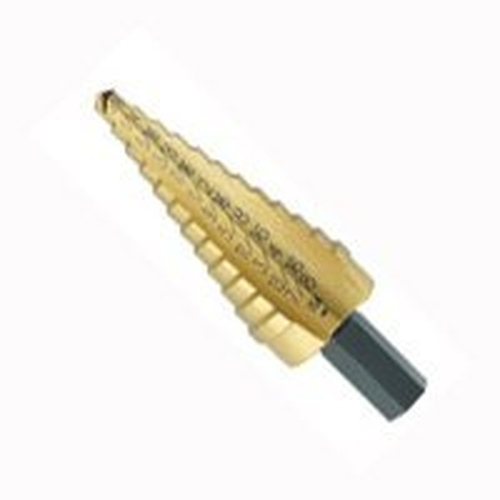

Not much call for drilling a 7/8" hole thru gelcoat, so hard to recommend a good bit to choose.
A stepped bit would be my 1st choice, but I have NO specific reason, other then it seems a good choice. Again, never done it........
to drill the 7/8" holes
