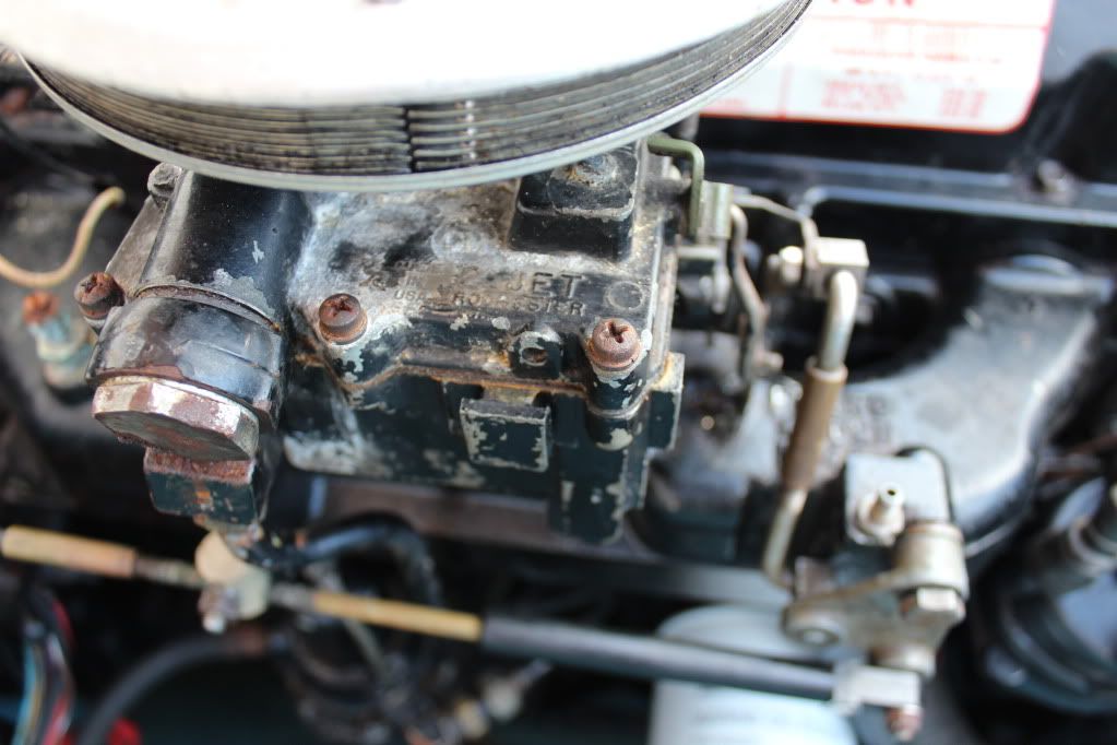

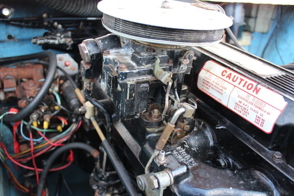

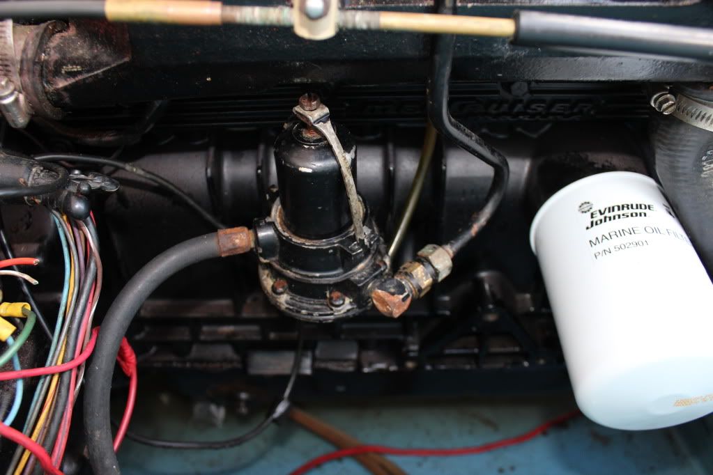

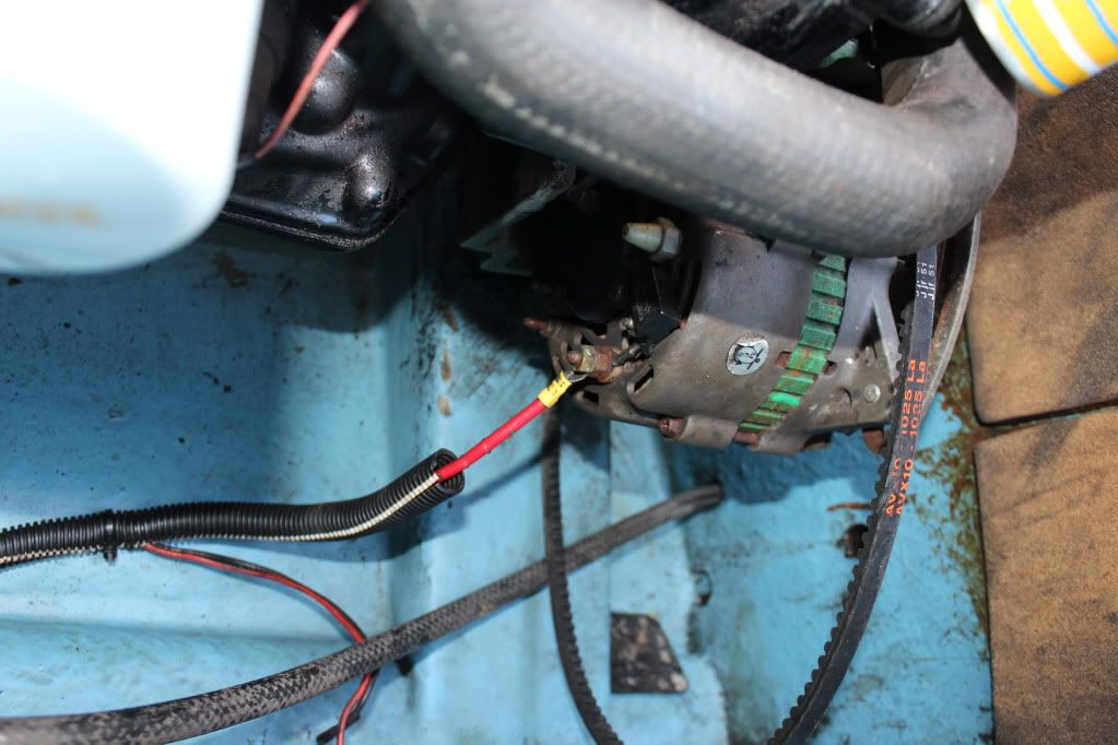

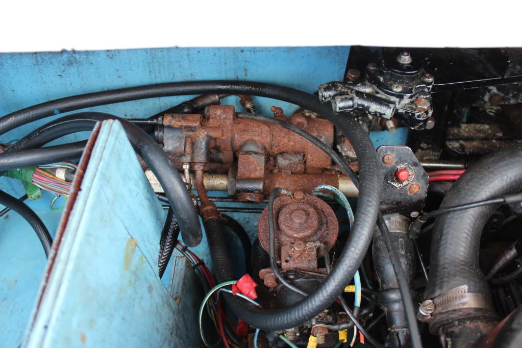

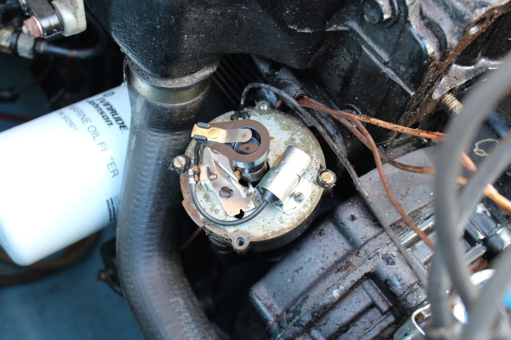

Incidentally here are some detailed images of the engine as is.
Dizzy -
Rochester 2bbl
Alternator single wire
Fuel Pump
Teleflex ( no power steering fitted)
General Top End
