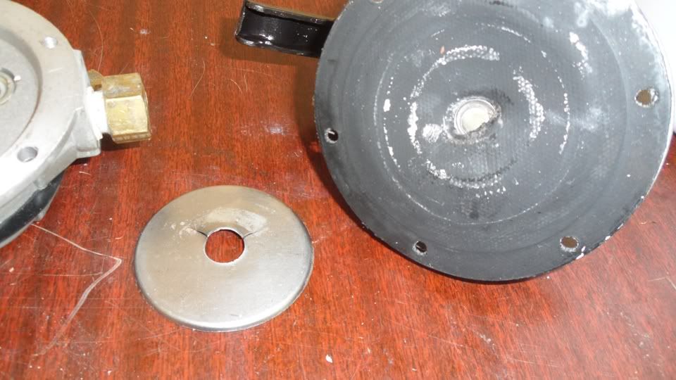

After a beautiful day on the lake yesterday, came home and tried to fire up the boat on the muffs... Ran out of gas! (but.... I had just filled the tank at 3.69/gal. Yikes! That's a story for another thread). Troubleshooting isolated a bad fuel pump. Trouble is, I just replaced this pump 7.5 engine hours ago. It is an aftermarket (Sierra) pump. Guess I will look for OEM...(yes...tried to save a buck or two...but look at me now! I count my blessings that I wasn't at the far end of the lake when it decided to quit!) I had read on here that "some" aftermarket parts are ok, but stay away from others. Another experiences like this? What is the "best" carter style pump I should go after?

It isn't apparent anywhere on the pump or the single page of instructions that came with it. The "one-star" review of this product on Iboats by another consumer written last year says his sierra fuel pump was stamped "made in china". All mine has on it is "C10". After I got the pump and opened the box, I could see the quality/construction was not anywhere near what I was replacing. Crossed my fingers and put it on anyway. At least I am getting good at removing / installing these. Had this bad one off in about five minutes this morning.
