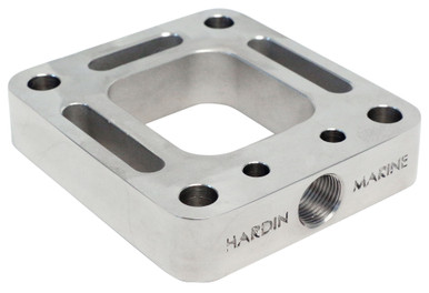

So I was able to get this installed a few weeks ago and try things out. Only install issues I had was needing 1" longer bolts for the elbow as this 1" plate was sandwiched in...(stock is 5.75" long needed a 7" and trimmed off 1/4"), and the o2 sensor sits so close to the top of the manifold I needed to grind down the 3/4" pipe plug in the manifold top so the o2 sensor would fit... Harden could have made the plate a tad thicker..
Luckily the factory hardness that came with the gauge was long enough to get up to the cup holder by the helm which was convenient to stick the gauge in for a temporary install. This is the guide I was using for AFR targets- https://www.innovatemotorsports.com/tuning-a-marine-carb/

This is the sensor plate goes between manifold and elbow, you need 4 x longer bolts (6.75" long), plus a sensor of your choice
sensor plate-
Sensor Kit - https://www.amazon.com/gp/product/B0184TSI84/ref=ppx_yo_dt_b_asin_title_o03_s02?ie=UTF8&psc=1
Kit has wiring between sensor and gauge plus power supply harness. I just took a spare supply fuse under the dash and unplug it when not in use.
