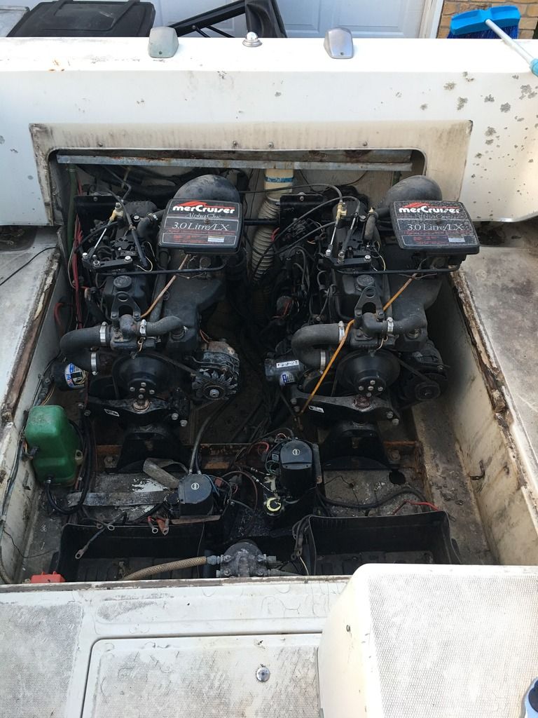

I picked up a boat with twin alpha 1 g2 outdrives.
Boat was laid up over 10 years ago because of a sterndrive problem.
I havent had much time to play with it,i have determined a few things.
-Alpha 1 g2 outdrives,140 gm engines.
-1 outdrive was unbolted already,removed it to find shift cable was broken....hoping that was the initial problem.
-both motors were tight to roll over.
Soaking in aerokroil at the moment.
Looking through plug holes,all cylinders still show cross hatch hone pattern.
- oul in engines is clean,fresh.
Engine bay shows water stains upto bottom of the oul pan.
1 engine starter is sticking.
One thing i dont like s no good way to roll the engine over by hand.
So i have alotta work ahead of me.
The hourmeter on the dash shows 1200 hours.
Before i plan to sink any more time and money into this outdrive set......are they worth repairing,dependable?
I always avoided sterndrives,horror stories bout sinking boats....ect.
But alot of that comes down to maintence.
Ill discuss the boat in another thread,its an older boat that was updated with the alpha one g2 drives and motors.
