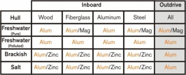

Fresh Water Areas -
620 - 1180 Millivolts with Digital Meter
Salt, Polluted or Mineral Laden Water Areas:
750 - 1180 Millivolts with Digital Meter
And Note: more anodes does not mean more protection, actually it can mean less
That said, staying on a lift its a non-issue

my daughter sad you put an attachment in your reply clicked on it so im reading through it . you'll have to excuse me , im not very good with computers . just a freaking old guy
freedive
Aug 22, 2017
34
i finished the attached article . good information , but how do you know what size the hull zinc has to be . was thinking a for a 25" boat like mine , a 4" X 6" x 3/4" zinc should be about rite size for transom .would you have any ideas .
