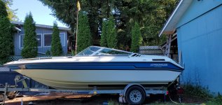

I'm so sorry if this has been covered... Honestly I think I've read every thread on v6 to v8 swaps lol
So I've got a 1991 21 foot prowler boat made by cooper yacht... It's very similar to a mirage.
It's time for a new motor and I've done a lot of research... But have a couple questions... Let me say that it now has a 4.3 with a mr drive... And I'll be installing a 5.7 vortec (97 roller motor)
I have a good grasp of requirements it get the motor marine ready... And I will be installing a new outdrive. I have the room for the engine ... But the pedestal has to be enlarged/ lengthened to accommodate the v8.
So I know that I have to add to the pedestal... Just wondering what the best way to go about it?
And I read one thread where the owner also added to the top of the existing pedestal... Saying the the mercruiser v8 mounts sit a bit higher... I believe he added a 2x4 to the top..
Any information is a huge help.
