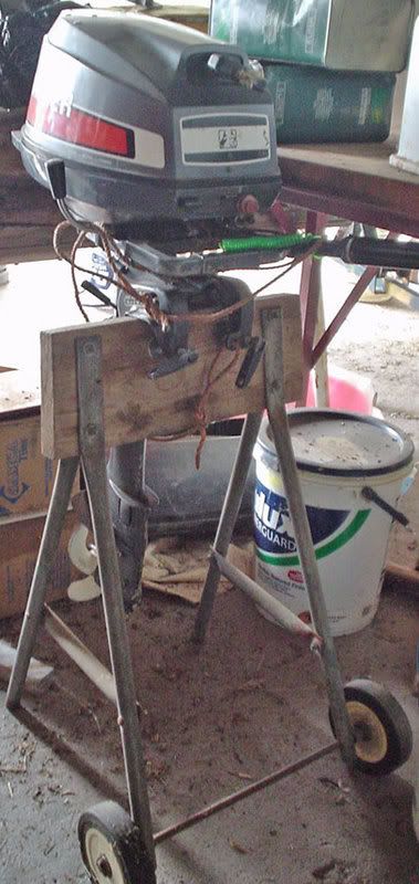

Pony
Jun 27, 2004
4,355
Re: anyone have plans for a OB stand?
Those are my two, I know the Johnson one is in a couple of those links above. Both are still working just fine. I do wish the one for my 25hp was a little wider and a little higher. The height it is at now is just a hair to low to make it wasy to change the lower unit lube while on the stand. I can fit a pan down there, but can't get the screwdriver at the right angle. The stand my little fisherman on has since been modified a little. The board that I clamp it to is longer than in the pic so that I can rest the entire transom clasp on it.

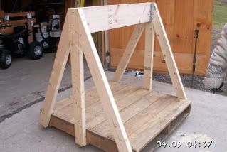

Heres mine, I didnt really have plans for it, just kinda did it. Its on casters so I can move it around easily. Its not really as big as it looks in the picture. The pallet is about 3 feet square.
jonb14
