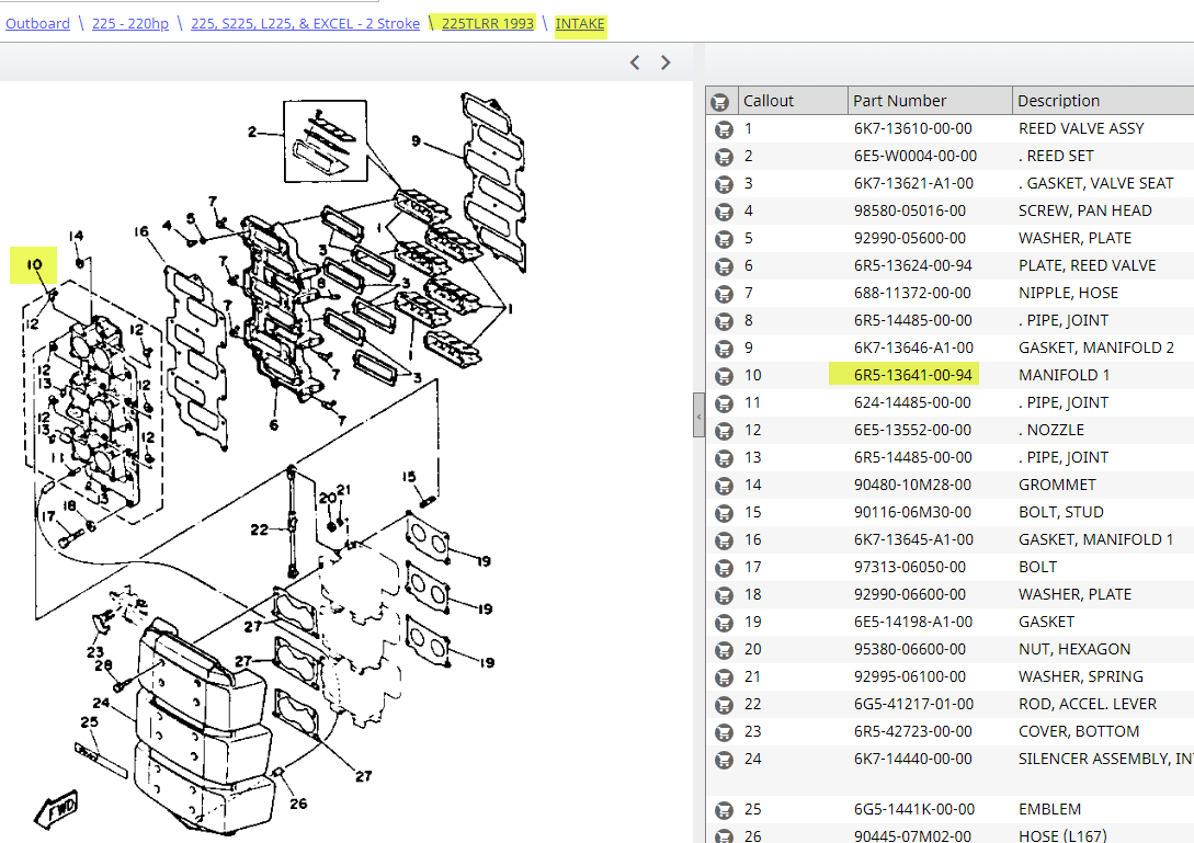

Correct me if I am wrong, but I think two strokes don't have intake manifolds. I'll check compressions again and report though

Oh yeah, right behind the carbs. I'll spray them and see if RPM picks up. I've sprayed the carb throats to see if I can find signs of fuel deprivation and found no changes, does that count? And if there is an air leak there at the manifold it would be because the carb bolts are loose?
