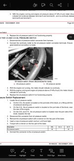

so this has come up a few times lately.... the tks/tbv system looks different than the TB iv in terms of the alarm system. all of the alarms go through the icm in tbv, and the op switch for the warning is NC with engine running.
unless I'm reading things wrong. otherwise all of the recent advice to disconnect the op switch for testing is wrong.
