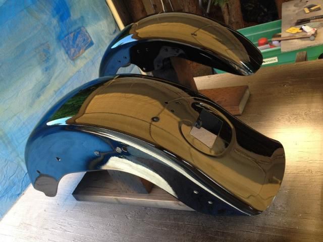

I just got done repairing and painting two fenders from a Harley, that got beaten to death in a fall off of a trailer loading ramp. It took a long time but I am very proud of the results. They are black and they look real good after their paint job.
My question is, how long should I wait before going after them with a polishing wheel and cutting agent. I used three base coats and five clear coats. It has been three hours and I can now touch them. I wouldn't want to handle them yet as I feel they would still print. I had one minor sag of the clearcoat which needs to be color sanded out and minimal orange peel.
How long should I wait?

Bob's Paintland, of course, MT. Corner of 99th and Hwy 99. It was whatever they sell for automotive base coat/clear coat. Nice thing about Bobs is that when they can, they will sell you pints. The base coat got thinned with medium reducer, 1 to 1. The clear coat used 4 parts clear and one part hardener. They came out pretty darn shiny, but I have one sag that needs wet sanded and a wee bit of orange peel that will disappear under the wheel.

The paint vendor told me 3 days but I had always thought it was like 2 weeks.

I have bought a lot of paint from Bob's, they are very good at what they do, I would give it at least a week before I started sanding on it, also when I was young, we used to paint spare pieces of metal and get runs on purpose, so we could test sanding at different stages that way we knew when we could sand the final product.
How has the humidity been there lately, even with auto paints with hardener in them, the humidity will make a difference.

The humidity was low today plus I had a fresh filter on the HVLP gun, However, on one of the early coats of clear, there appeared a water droplet on the paint. My friend asked when the last time I drained the compressor tank..It had been forever. We opened the valve and nothing came out, We stuck a little screwdriver up in the valve and probably a pint of the ugliest liquid started to ooze out of the tank. After that, we had no issues. Three hours after painting, you could touch the surface without any tackyness.

Thanks, Bob. That's what my friend and I concluded. If we did that well with black just about anything else would be possible. I went back out this morning and looked them over. They are so near perfect I am not even sure I want to do anything more to them. The one little sag I have, on the back trailing edge of the front fender is hardly even noticable.
