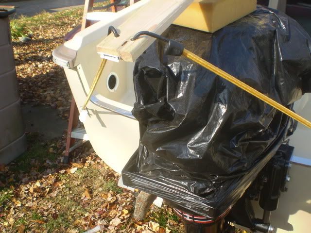

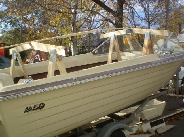

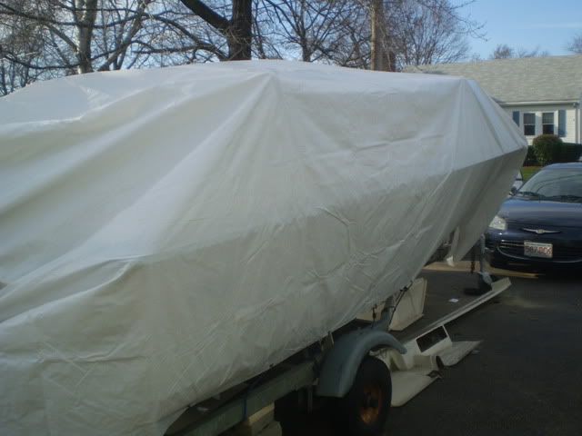

Here's my rig for covering up my boat. I'll use Bungee cords to hold the tarp down. That way, I can still have easy access to the interior. Even if it gets cold I can still do the rigging. :p
One other note... I looked all over for a good tarp. I found it at Overstock. com. I got a 14' x 20' er, 12 mils thick. $40 bucks. They have a special on shipping... $1 buck! how can ya go wrong?
Update....... I rounded off the ends of the 2x4's with my belt sander. Less chance of ripping the tarp.
The center board is regular 1x3 strapping. Overall it worked out nicely. The metal brackets will allow me to fold up the saw horses and store them away. A total seven peices....... easy:)

Ed, your support rigging there is fantastic. Any chance I could move this thread to the general boat section so others could benefit?

That is SHARP! what did you use for the board that runs down the center line?

wow, that is supper! are you going to put some thing on the ends of the cross bars,so they don't tear the tarp?

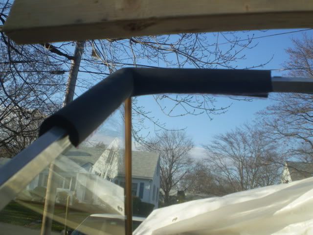

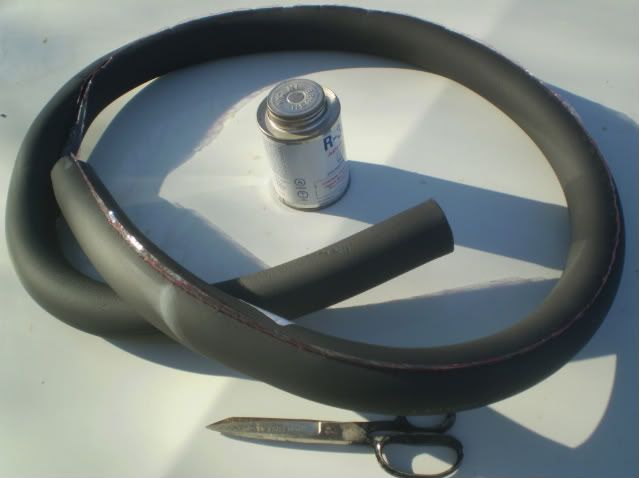

Now that I had the frame built, I wanted to add one more thing.
I went to the big box store and got some 1/2" rubber pipe insulation.
I cut and fit a piece for each corner of the windshield, Sniped the insulation at the inside corners and glued.
Lastly, finish putting on the bungees and she's ready for a winter nap.;)
