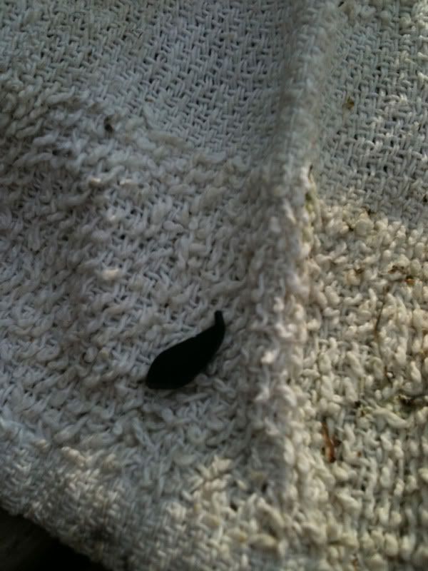

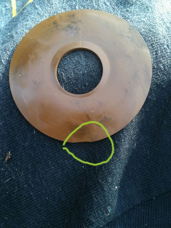

i went and took it apart. and what i found was actually interesting.
1st findings are that this is a very simple machine.
2nd i found a rather large piece of plastic in there. i checked every inch of that pump and cant seem to locate where it came from. so my guess would be when i broke the fuel inlet elbow a few years back a piece went up and not down. who know. but its not from the pump.
3rd the large rubber washer has a nick taken out of it. very small on the edge. i took pictures of both items.
and lastly i shot a short video to show the flow that im now getting through the pump which is indeed more than i had before. but still seems like not enough. please view the video and let me know what you think.
thanks.
