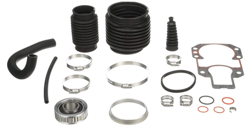

We have a 1995 Wellcraft with a 3.0 Mercruiser engine and an Alpha One Generation Two outdrive. Is there a kit available with all of whatever is required to change out the bellows or do we need to buy the parts separately?

you also need a tube of bellows adhesive, also not a bad time to do the shift cable if original
dubs283
Jul 27, 2005
5,332
I piecemeal the parts. There's no kit oem or aftermarket that I know of that includes every component for a proper full bellows job
I replace the lower shift cable (complete kit), trim senders and all the bellows/rubber at once. This way everything maintenance wise is new/oem
Mercury recommends bellows replacement at 5 years
