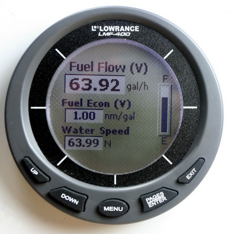

If you do not want to do that, get yourself one of these.
You calibrate them by filling an empty tank, recording the total number of (full) gallons. Then they calculate fuel remaining by integrating fuel flow over time. They are very accurate if you start with a known qty of fuel.
