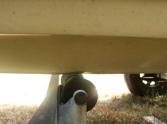

With everything being waterlogged, and my keel stringers being mush, one of my trailer rollers has pushed in the keel in one spot.:eek::eek: I havent read any post on this.
I am going to try to post a picture of it so maybe you guys can tell me how to fix this.

i've seen much worse. redo you internards.

I think he means that your crossgrands are wet, and you should patch it with a fillerbus.
Seriously, you need to fix your internals - replace the wet wood, else any patch you make will crack right off. Once that's done, repairing this pushed in area of the keel with epoxy putty and maybe a little glass is easy.

you structual frame inside is rotten.

I have the hull gutted. There is just a small hump inside. I guess I shouldnt worry about it? What about the outside? Will that indention make a difference in performance?

hopefully when you do the inside, it will help straighten the outside. then fill in the outside as described above.
