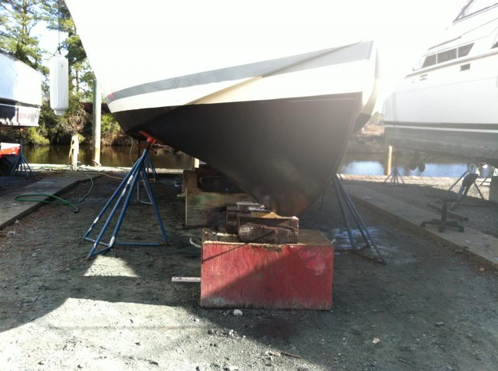

Whats involved in painting our boat bottom? We need to remove the barnacles too. Also which apint is best,interlux? 35 foot express.

The boats in NC right now. Were bringing it up at the end of the month. We wanna do the painting before it.

Done
