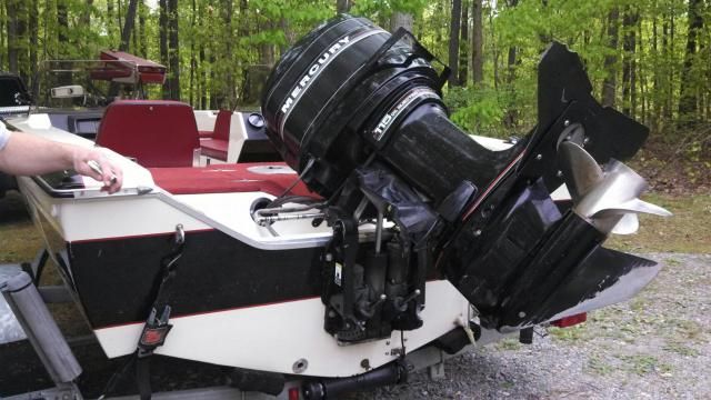

thanks for the warning, smokeonthewater. I don't want to break it. Looking for a manual and deciding whether I want to tackle it. Here, in detail, are the symptoms I'm getting:
1. Starts alright, though a little hesitant (I pump primer bulb until tight, turn on ignition, hold prime for 10 seconds, raise throttle, then crank & start)
2. Upon pulling away from dock it runs a little rough, but doesn?t die if I?ve let it idle for a couple minutes first
3. Past no wake ? nail it ? it?s slow to plane. Cannot get on plane without giving full/close to full throttle, and then it tops out at barely 4K RPM (just me in the boat)
4. Then after a few minutes ? this is inconsistent - gets better and smoother, and will turn around 5k
5. Then, few minutes later, it completely clears and leaps forward, very smooth, VASTLY more responsive ? I can pull way back to part throttle and maintain mid-30s at around 4000rpm, with great acceleration from that point. At full throttle it?ll turn about 5800-5900 rpm and hit 49mph on speedo & GPS (speedo is apparently accurate). After this, it runs fine for the rest of the trip. After clearing up, it?ll jump onto plane VERY quickly, and is very responsive. Huge diff.
I?ve had it out three times. Second time, before going, I started it in the driveway, and sprayed some seafoam into carbs. Spraying into #2/middle carb had no effect - engine did not stumble as it did when spraying into the other two carbs (and I sprayed a LOT). I went around behind motor and yanked plug wire from #3, no effect on engine. Did same to nos. 2 and 5 and got zapped each time, and motor ran rougher, as expected. Took it out to the lake? ran crappy for first ten fifteen minutes, then woke up and ran fine rest of the trip.
Next day - pulled plugs. They all look about the same. Started in driveway before leaving & checked spark with spare plug on each cylinder while engine running, and to my satisfaction it had spark in all six. Took it to the lake, thinking it magically cured? and at first it ran crappy, as related above. After a few minutes it cleared up and ran fine. I?m stumped. Intermittent spark? What to replace? Or should I just disconnect/reconnect every wire, making sure they?ve all got good contact? Or carb/float problem?
I?ll be grateful for any guidance...

Follow-up: turns out it was spark, a failing switchbox. I went the prudent (or paranoid?) route and replaced both. Shop wanted nearly $700 to replace boxes; I picked up a couple new ones off ebay for 200 total and put them in yesterday. Nice and smooth now, easier starting, better idle, all-around much improved. I think the engine is fine. Plus, that big tall Merc just looks cool...
